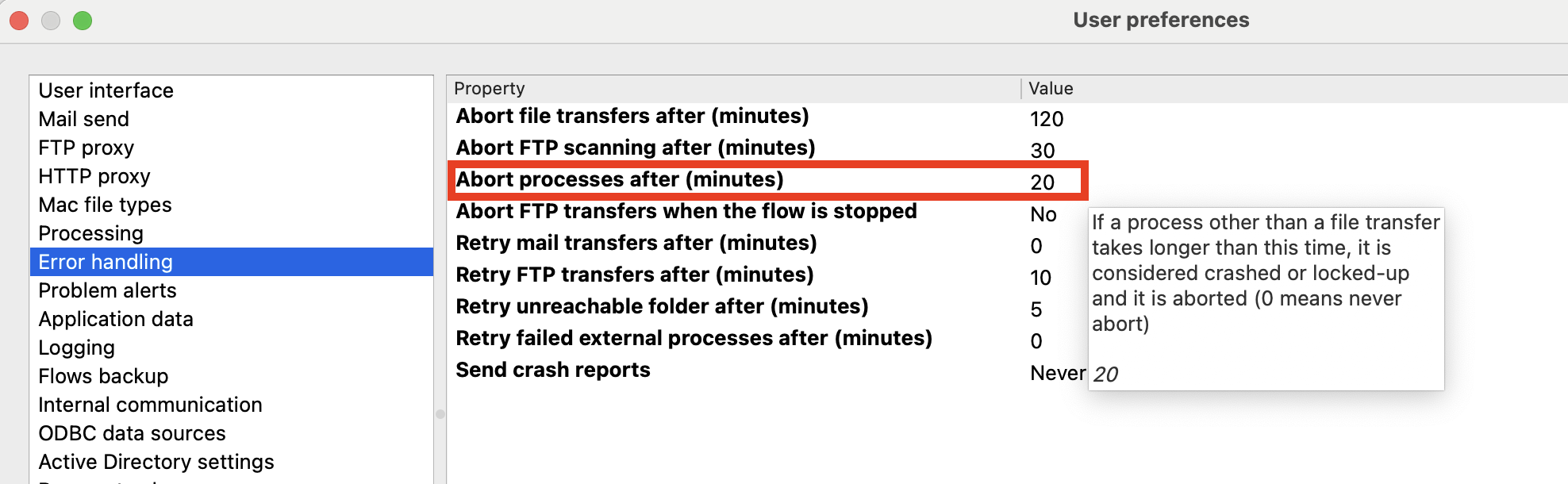

How long does it take to process? Is it possible that Switch is aborting the process because it is taking too long?
Consider increasing the default value.
Screenshot 2025-03-21 at 8.08.25 AM.png (217.87 KiB) Viewed 18093 times
