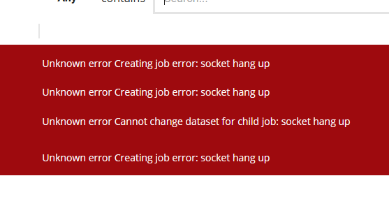

I’ve seen these socket errors in all sorts of variations and across multiple Switch 2024 Fall servers, so at least you are not alone 8-)
Most of the time it’s HTTP request (20.3), but indeed not exclusively;
Unknown error Creating job error: socket hang up
Unknown error Cannot change dataset for child job: socket hang up

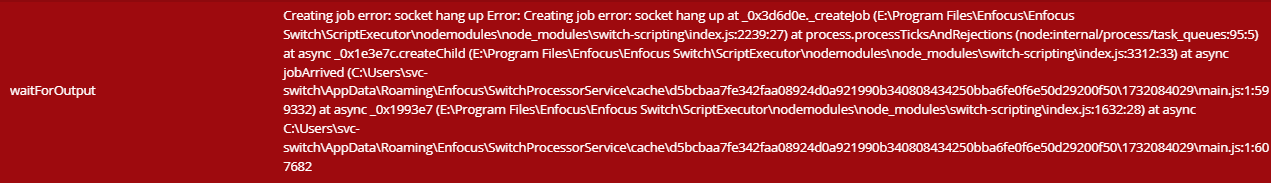

As of today, 'Wait for Asset' joined the party;
Creating job error: socket hang up Error: Creating job error: socket hang up at _0x3d6d0e._createJob
I haven't found a workaround, after a while I gave up and routed the error jobs out of Problem jobs to 'auto retry' these.
