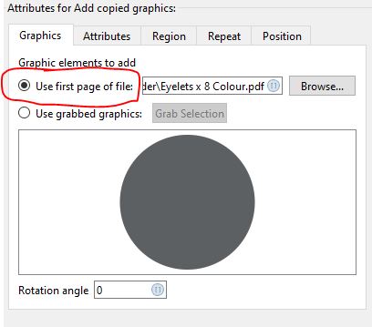

Loicaigon, I like this the best but my action list editor does not allow for multiple pages, just page 1.
Am I missing something?

- Capture.JPG (23.59 KiB) Viewed 29949 times
Re: Faster way to add a copied graphic
Yes, an upgrade to PitStop 23u1 at least where this property was introduced.
But upgrading to upgrading, consider the latest version!

Thank you loicaigon,
I have installed the upgrade and it worked a treat!
Cheers
