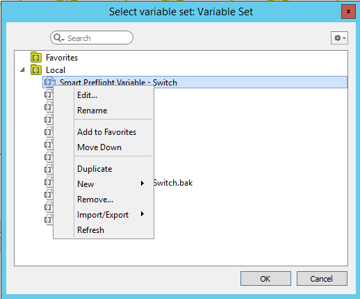

You can edit the variable-set from within Switch. When you do that, you can use a "single line with variables". This makes it possible to use the private-data.
To edit to edit the variable-set:
- select the variable-set in Switch
- in the popup, right-click the variable-set
- click "edit"

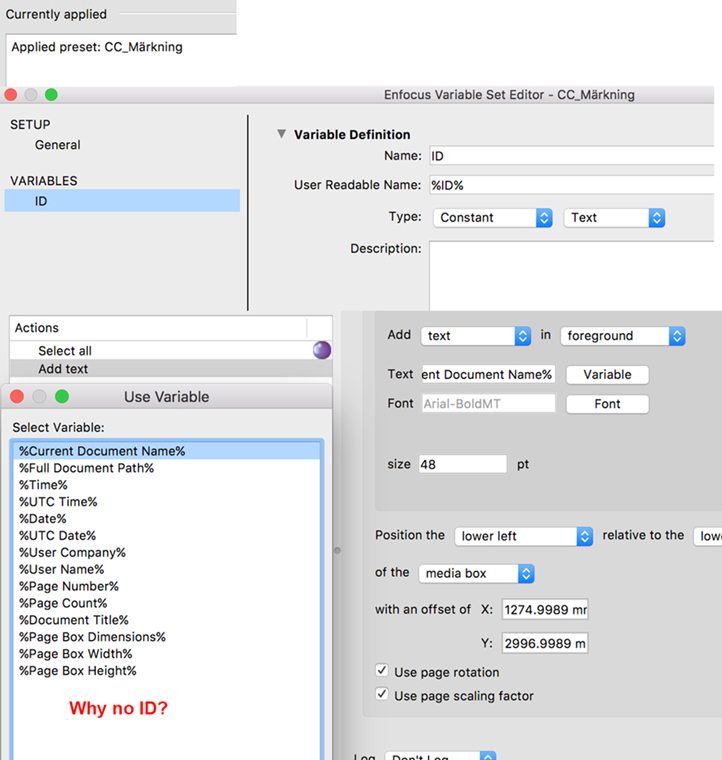

Well, I have partly gotten it to work, but unfortunately the output is not what I want...
I have created a new variable set with one variable called ID with the readable name %ID%. I have exported this variable set and put it on the Switch server.
I created an action list which will add a text, but for some reason I can't choose the variable %ID% when I click on Variable in the Enfocus Action List Editor and if I type %ID% in the Text field that is what I get placed on the pdf, even though I've selected the Variable Set in Switch and edited the %ID% variable to be the Private Data I want placed on the pdf.
I have verified that I have enabled the new variable set in PitStop, but still I don't get the variables from that set when I click on Variable in the Action List Editor. Any ideas why, as I think this is the reason it's not working the way it's supposed to?

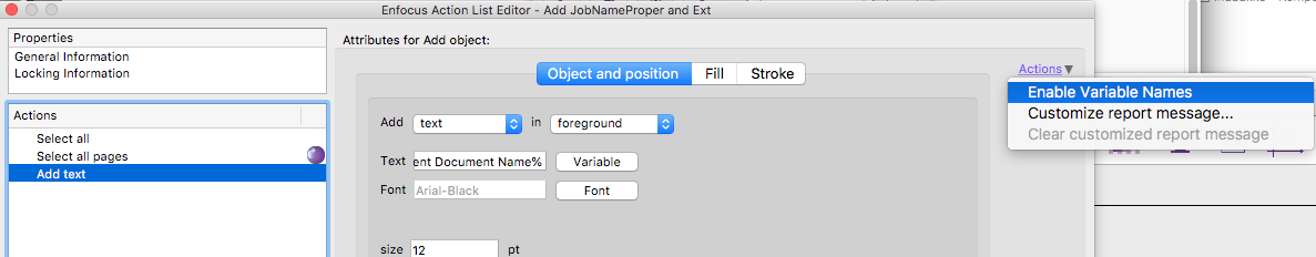

Ahh, you won't see the variable you created if you just click the button "Variable". That only shows the prebuilt variables. In the upper right corner of the dialog you should click on "Actions" and choose "Enable variable names".
When you have done that there is a new light blue ikon in the value field. Click that and select the variable set you created and then the variable you want to use.

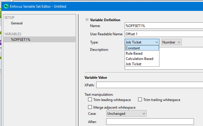

I have a similar question. The part I'm hung up on is the step right before that where I'm creating my own variable set. I need 2 variables, and the value of those variables will come from a calculation within a Switch flow that includes PitStop Server and an action list referencing this variable set. Problem is, I can't figure out how to create the set to access a Switch value. This pop-up seems useless:
. Shouldn't there be some option i.e. "Switch Variable" or some such? I find Enfocus' documentation always at least one step short of actually making a connection with my brain, but in the case of Variable Sets, there's at least 4 steps missing - Attachments
- Screenshot 2025-08-06 at 8.45.07 AM.png (86.88 KiB) Viewed 36362 times
Re: Add text from Switch variable to PDF
If you want to get value from some metadata from within a Switch flow, you simply need to select the variable set from the PitStop Server Switch app, and edit the variable set there. If you have the Metadata module, you would have access to a "Text With Variables" variable type and there you could pass the value of the metadata.
We have the metadata module, but I'm not seeing the "Text With Variables" option. I should say, I see it when in Switch, but are you saying I should be seeing it when in PitStop Server - in the screen shot I included? And further, if I can't define it correctly when *creating* it to begin with, in PitStop Server, how will I ever be able to select it in the configurator in Switch?
