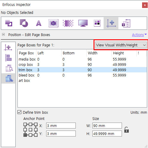

1_Inspector_page boxes view.JPG (129.84 KiB) Viewed 6788 times

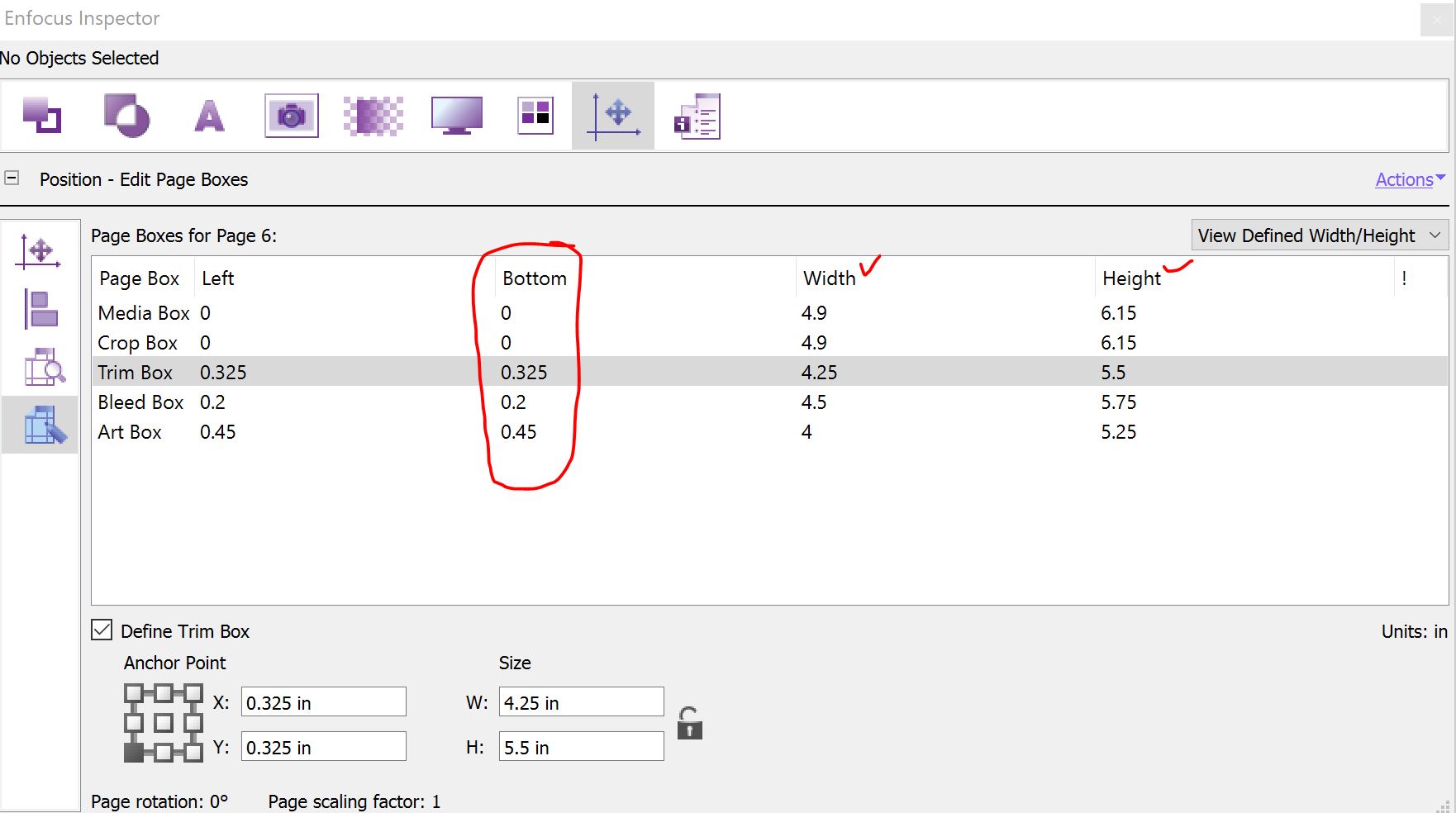

And then I had an error today where I added two pages (see above). I believe that the Bottom column (circled above) had different numbers on the two pages added that differed from what is seen here. They may been .5334 or some other arbitrary number. My point is that having different numbers in that Bottom column even though the width and height of the other respective Page Boxes were all identical, affected the outcome of the imposition with all the cards that were imposed on pages 1 and 3 being off-centered.
What I did to resolve it was to copy page 2 and duplicate it twice. I then deleted the existing content and pasted page 1 to one empty page and page 3 to the other empty page and centered both to the bleed box and this resolved the issue.
