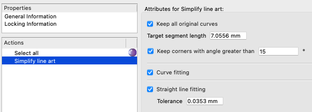

If you have PitStop Server icw Switch, you can use Enfocus PitStop Server PDF2Image.
If not, you can use Execute command icw ImageMagick.
But a better approach may be to reduce the number of nodes in the paths without changing the appearance.
PitStop offers a “Simplify line art” action for this purpose.
Also useful with cut lines.
Simplify line art.png (28.32 KiB) Viewed 49812 times

Tryd that already but with no result. Customer design everything in illustrator. File is not that heavy but for the rip its to much. So we making a Tiff file from the PDF and then drop it in the rip. That works.

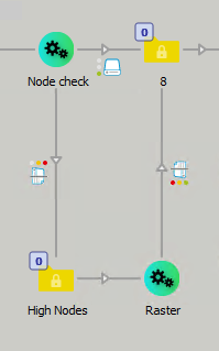

For high node counts you can do a node check then if over xxx raster.
Screenshot 2025-11-11 at 10.40.51.png (32.5 KiB) Viewed 49666 times
There's an option to keep text live if needed.
Malcolm

I found "find complex pages (over 5000 nodes) and Rasterize them at 600 dpi". Wil try it withe that one but it takes verry long time to proces. Iif i try it in standalone Pitstop pro my acrobat is freezing and crashes.
