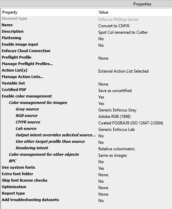

St3ve
Posts: 16
Joined: Wed Oct 09, 2024 1:27 pm
Re: Spot Col to CMYK Conversion
Post by St3ve »
Update: I have managed to achieve the output required by applying these properties settings.
