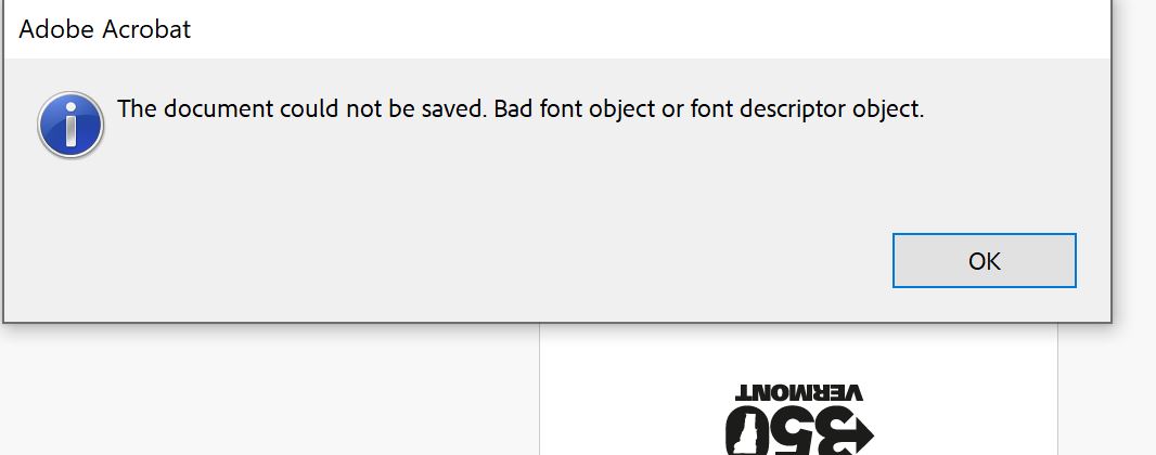

I have another issue related to this Action List aside from the original issue related to the cut-and-paste problem.
My action list is completed and it does precisely what I intended it to do, however, when it finishes it appears to have some sort of issue that prevents me from saving it. I am given a "bad parameter" error.
Bad Parameter_cannot save.JPG (30.88 KiB) Viewed 14955 times
The only workaround I have found was to extract the page and then save the extracted page. But it would be great to deduce why this happens and resolve it. I added a "remove metadata" action step at the end, but it doesn't appear to be the solution.

Post by loicaigon »
I can't reproduce this. You may want to contact support.

Post by JimmyHartington »
I have also tried on macOS 15.7.2 with Acrobat 2025.001.20813 and Pitstop Pro 25.11 with no problem.

Post by prepressman_ntsf »
Are you saying to contact Adobe support with the issue?

Post by loicaigon »
Which PitStop Version are you using?
