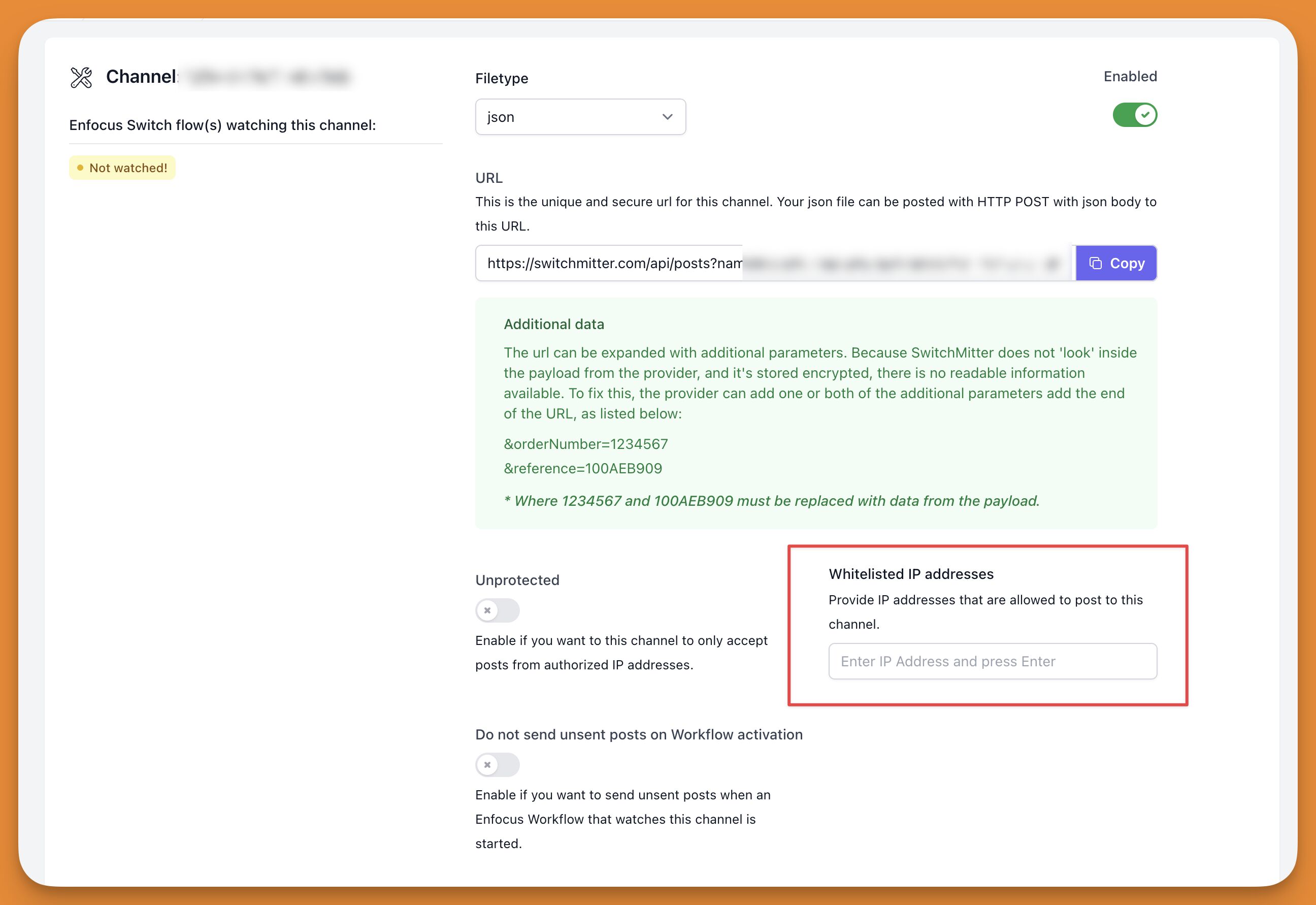

As an external service I have tested SwitchMitter.
Unfortunately there have been some legacy network issues at our company, which is not easily fixed with the need to change A LOT of other stuff, which have prevented me from implementing it.
But they have the option to whitelist IPs and also store the request in case Switch or your network is down.

Switch Mitter is really easy to use and already covers quite a few of the security points you mentioned, with the only downside being that it’s not as fast as a direct Switch webhook.
