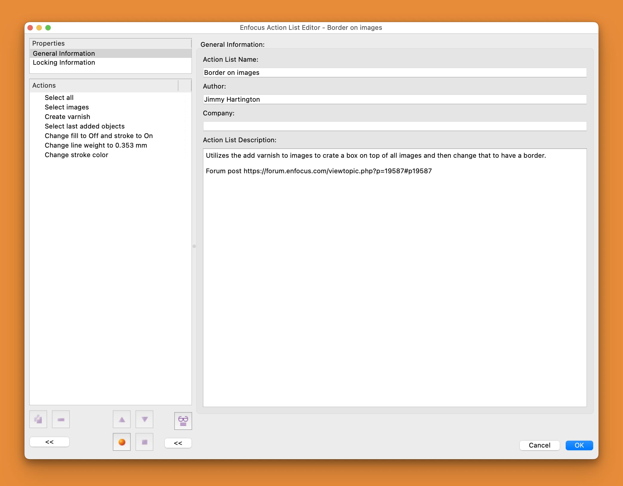

Is there a way to add a border outline on every image found in a PDF?

The only way I can think of is to utilize the Create varnish.
So the process is to select images.
Create varnish and then manipulate the add varnish objects to have a border.
See screenshot below.
You can download the action here:
https://github.com/jimmyhartington/pits ... images.eal
