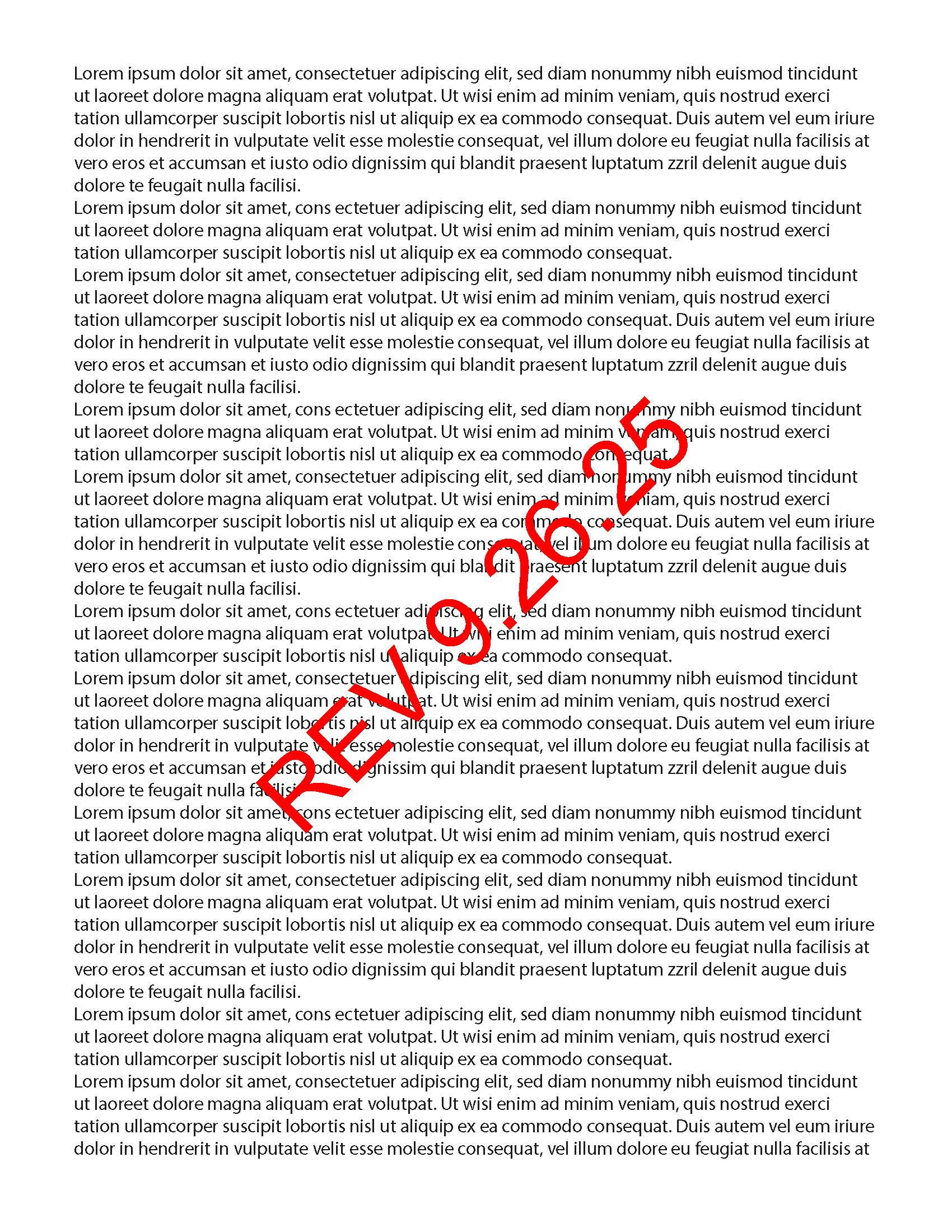

We have one specific client that prefers their previews to have a custom "watermark" where it's just a bright red text with the month, day, and year on it (MMDDYY) from the day we're creating the product. Now I have finally made an action that sort of does it but it's using the Pitstop default %Date% and I tried making my own custom variable to pull from but I am not getting it done right at all. So I am hoping someone here can help me and teach me what to do. Assuming this is possible of course.
It does need to have REV before the date starts and it must read as REV MM.DD.YY
I've attached a sample of how it should look in Acrobat after running the action.

- TEST SS.png (129.8 KiB) Viewed 8770 times
