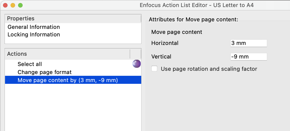

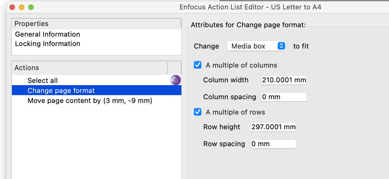

I have written an Action list which works, but it resizes the content
Screenshot 2026-01-14 at 10.11.56.png (113.05 KiB) Viewed 7717 times
Screenshot 2026-01-14 at 10.12.02.png (75.03 KiB) Viewed 7717 times

Hey
Quick tip: Look at Default Global Changes:
You can there ask not scale page content (i.e. select "Anchor page content…"
Later you can save it later as an Action List:
Hope that helps
