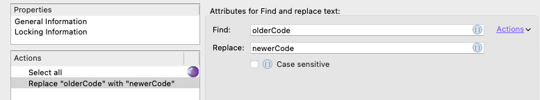

If your order number is unique, you may as well use the "Find and replace text" Action.
Screenshot 2026-02-03 at 14.34.14.png (21.19 KiB) Viewed 3723 times
