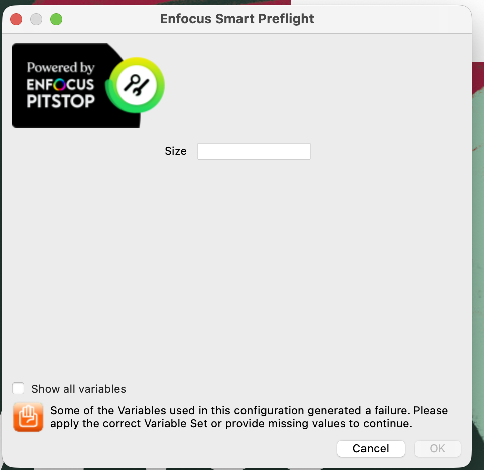

Sorry, looking for more help, I am probably doing this all wrong. I wish to add 3 checks to the smart flightcheck.
1st check : will be if a fix is asked for, if no then it does the standard flightckeck (size/rgb/bleed)
2nd check : if "add pages" is selected then the add pages action is enabled plus the standard flightckeck (size/rgb/bleed)
3rd check : if "resize" is selected then the resize action is enabled plus the standard flightckeck (size/rgb/bleed)
I am struggling with creating a correct variable set... I added what I thought was correct and it does not show when the PPP is started
Screenshot 2026-02-04 at 13.47.05.png (173.84 KiB) Viewed 13059 times

I think you are almost there, just set the Fix variable to be a boolean instead of a text.
Then enable variables in the EXTRA/Changes and apply the fix variable to the check button in front of all your actions.
By the way, for your variables "resize"…, if you set them as Boolean, in the "Fix" variable, your configuration will be easier as true|false will be presented to you natively without you having to type true or false.
