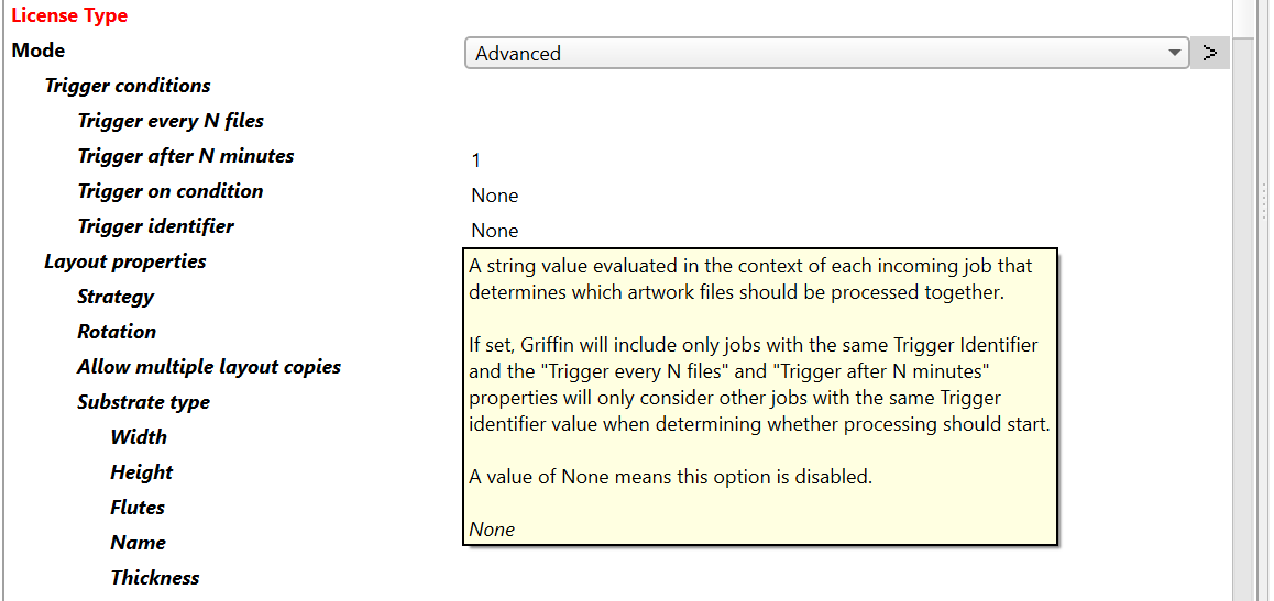

Re: Griffin Auto Issues
The older version had these trigger options. We've just moved to the newever version so now experiencing these new issues.
That looks like what's in phoenix. Looks like they may have missed that feature in the new app. Might have to put in a feature request.
plutinolabs You're correct they've removed the functionality from the new app. Not great.
I've come up wtih a way to release one batch of jobs at a time. With a script down stream from Griffin releasing the lock file so the next batch can process through.
I thought they just moved the funtionality of the trigger identifier to within the artwork properties.
