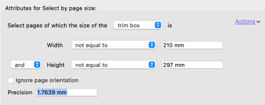

While the statement makes sense, you can already achieve what you are looking for without a IF operator. The IF logic is fundamentally tied in PitStop to a selection. In other words, IF a selection is found, Actions will operate. Otherwise not.
So in your case, you want to select A4 pages with bleed. For A4 pages, it's quite easy. You can select pages by their page size:

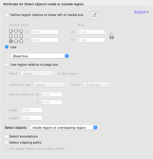

Now for bleed, it's a bit tricky because we have a "Check bleed" Action but it won't select actual pages. You can use instead "Select objects inside region and use the bleed box as reference.
Screenshot 2026-05-11 at 12.34.48.png (43.25 KiB) Viewed 1049 times
But there, you don't want bleed, so you can use NOT to negate those pages if they have bleed.
Seems complex but it is really not:
- Select objects inside region (Bleed box + inside of overlapping)
- Select page if content is selected (as we only want pages here)
- NOT (so that we have everything (including document, pages and objects) but not the previously selected pages
- Select pages by size => A4
- AND (so that we unite pages of A4 without any objects in the bleed area)
- Log (or do something with) selection
The downside is that it doesn't tell about pages "with" bleed. If there is an object biting by a fraction on the bleed box, the page will be disregarded. Which is what you want but maybe you will find the page to not have enough bleed still.
If you need a strict bleed check, you can still add rthe check for bleed afterwards.
