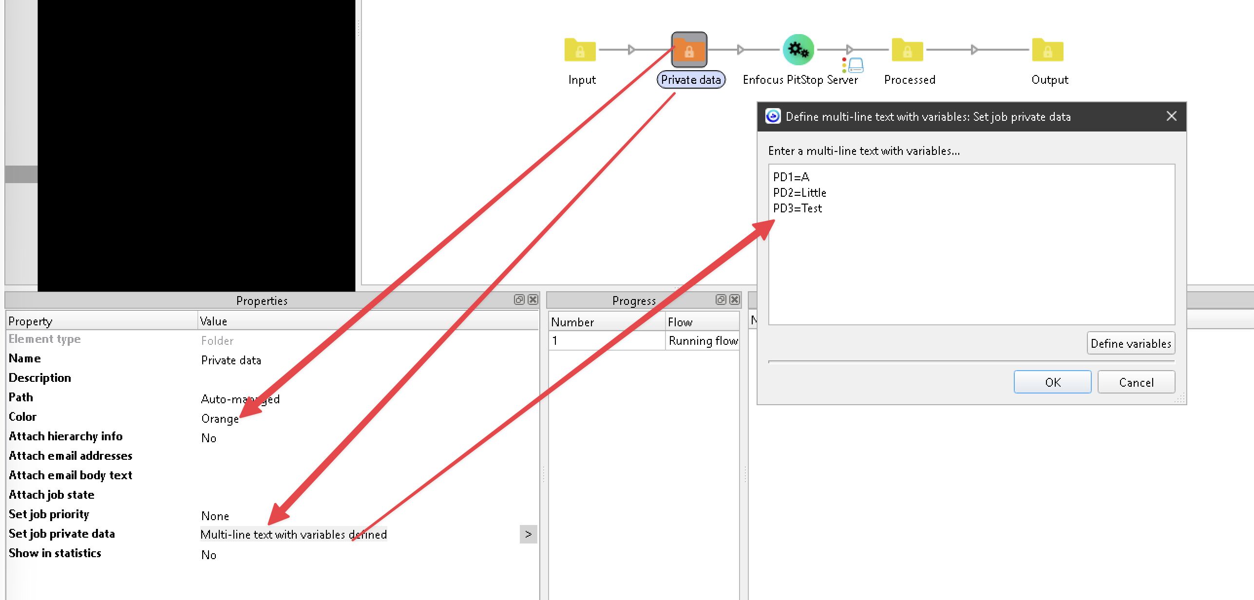

That's interesting. Thank you for that - I was unaware that you could edit the Variable Set from within Switch like that - but one note. I noticed your "private data" element right before the PitStop element. Where'd that come from? I don't seem to have it in my Switch 2022 Spring version.

Re: Stamping XML contents onto PDF
It is just a folder, where I set some private data for use in the the variable set.
I have changed the color to orange so I know I have set private data on this folder.
But rembember that the data for a variable can be any data/variable, which Switch nows on a job. And to use them you need to edit the variable set through Switch.
