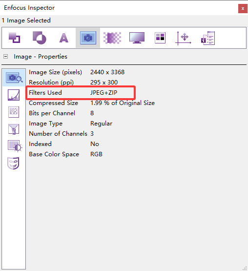

Re: A color conversion defect has been identified in Enfocus PitStop 25.
I suspect the issue is also related to the clipping path. Meanwhile, I’ve noticed another odd detail: the image is compressed with the "JPEG+ZIP" compression method.
- 2026-06-02_155708_410.png (21.43 KiB) Viewed 70 times
