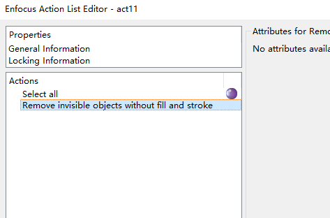

Thanks to the tip from the poster above, I’ve found the issue is fixed by first applying the action "Remove invisible objects without fill and stroke", then converting the images to CMYK.

Re: A color conversion defect has been identified in Enfocus PitStop 25.
Glad you got it to work.
Still hope you will send the file to Enfocus, so they can investigate the error.
