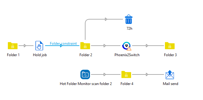

In addition, it's not so much the fact that the job waits in front of the element that bothers me the most, but rather the change in behavior.
Here is an example:
In this case, the job is held with a constraint folder, and the Hot Folder Monitor will no longer behave as it did before the update.
We've already encountered a few customer cases like this.
It's something we'll have to live with and explain to our customers, but the behavioral change was unexpected from their perspective. After all, who reads the patch notes anyway?
