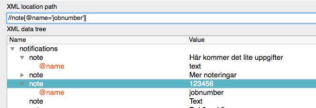

You can construct the X-Path to go by the tag and attribute value.
Then you are not dependent on the order of the tags, it will go by the attribute.
Screenshot 2017-01-27 16.53.58.jpg (37.28 KiB) Viewed 10362 times
Screenshot 2017-01-27 16.54.18.jpg (16.65 KiB) Viewed 10362 times
In your example it would be //dn:Row[@your_attribute='attribute_value']
Jan

You can only use a variable within a variable by scripting, but there could potentially be other ways of getting to dn:Row[x]. What Jan writes, for example, is worth investigating but if 'attribute_value' in
has to come from [Job.JobState] you have the same problem.
XPath has lots of functions and perhaps you can find a solution there. If for example the row you are looking for is the last one, then
//dn:Row[last()]
would give you the correct one.
And another possibility to avoid having to use Switch scripting could be to use an XSL transformation. 'Could be' because whether this will work depends on what the problem is, and you are shifting the scripting from one environment to another one: you still need to script and if you think Switch scripting is difficult, try XSL :)
