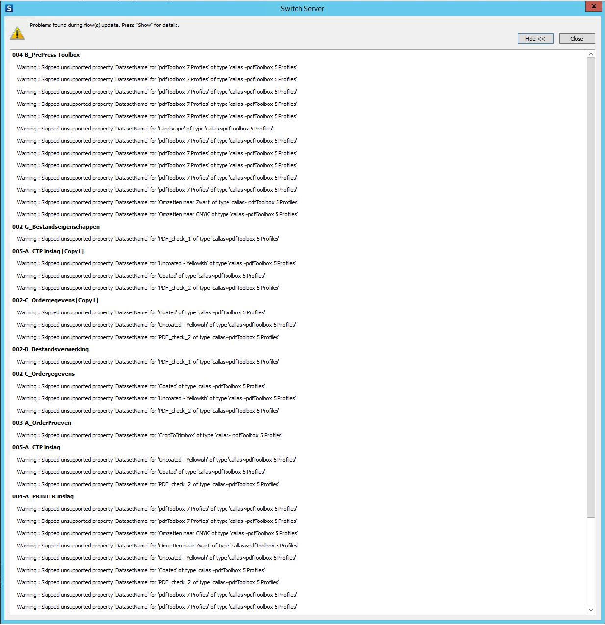

We've just updated Office, Adobe CC and Windows server in general. Everythings seems fine, but while restarting Switch, the configurators were automatically updated and afterwards we got these warnings.
Could someone please explain the details of these warnings? I understand it refers to some Callas segments.
The flows start without errors, but the jobs running aren't passing the Callas configurators.

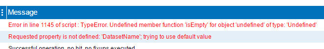

This is the detailed error message we get.
Schermafbeelding 2017-03-28 om 14.04.20.png (16.33 KiB) Viewed 14654 times
I think it has something to do with the report type properties, because when I turn this option off, the jobs are running normal through the flow.

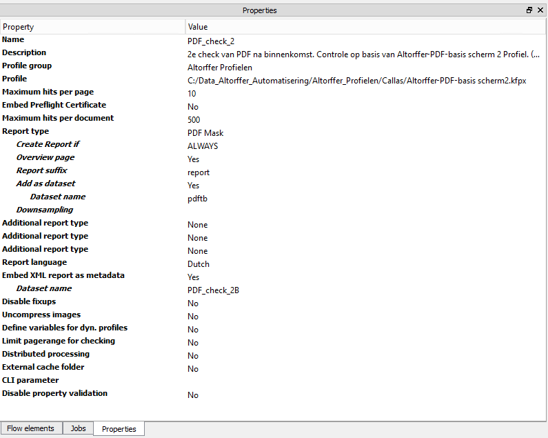

After the installation, total restart and update of the configurator, the datafield for the dataset name was available in the property window again. In its normal place. Only the default value was set, so I had to enter our own specific name which we used before.
