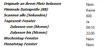

Hi folks,
in a special case we are using Switch to monitor a folder. We merge XML and PDFs and it works quite well.
In the morning of the next day, however, there are still some remnants that could not be assigned.
Before the workflow starts again at 9.10 am, we want to empty the inbox folder. Does anyone have any idea how we can achieve this with switch resources?
Monitoring the input folder with another switch workflow and, for example, emptying it at 9 o'clock in the morning, is unfortunately not permitted.
Many thanks for further suggestions in advance!
Arthur
