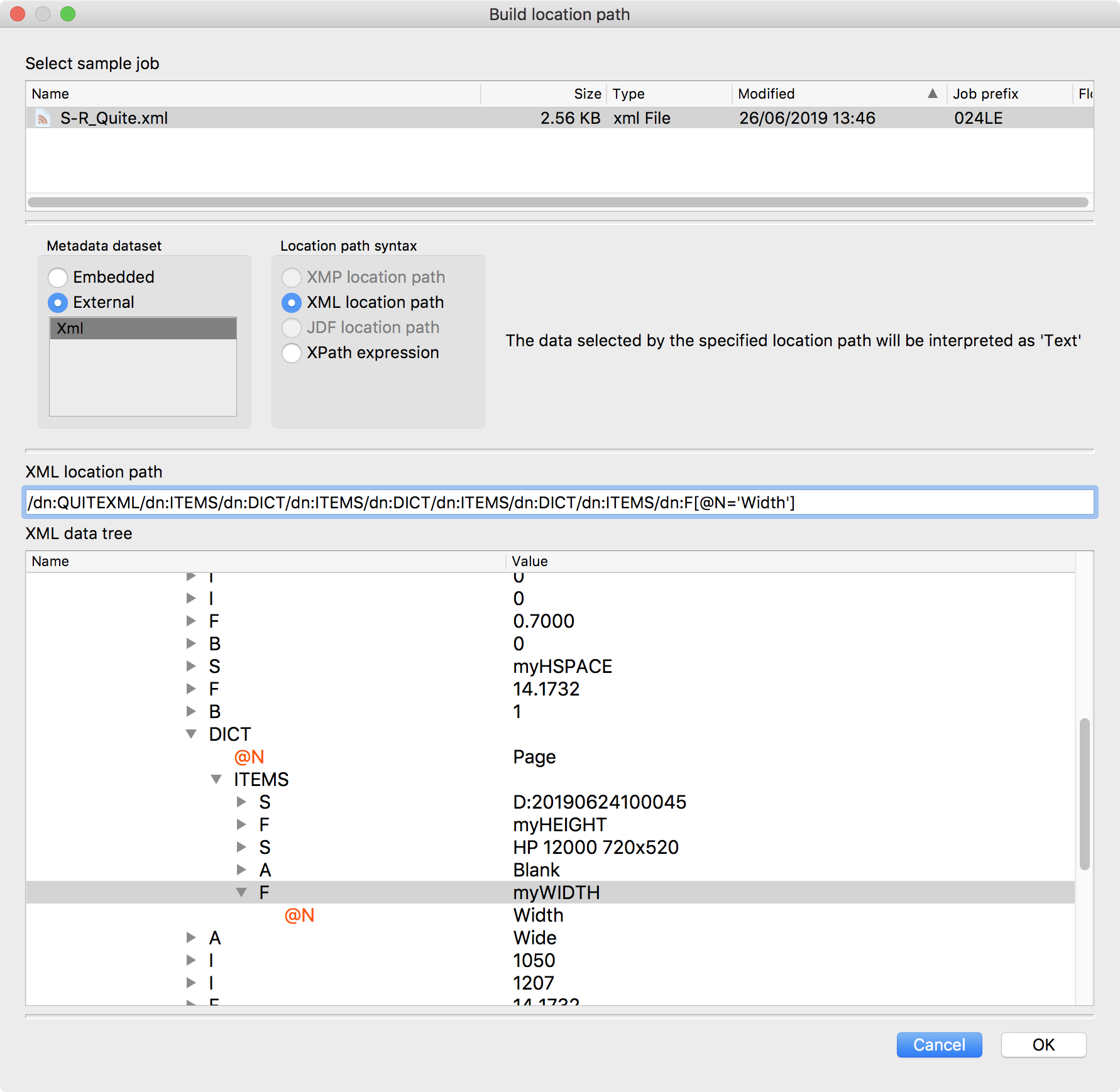

Is this the information you are trying to retrieve?
It seems a bit odd since it is not a number, but "myWIDTH" which you get.
This is the Switch variable:
[Metadata.Text:Path="/dn:QUITEXML/dn:ITEMS/dn:DICT/dn:ITEMS/dn:DICT/dn:ITEMS/dn:DICT/dn:ITEMS/dn:F[@N='Width']",Dataset="Xml",Model="XML"]
Screen Shot 2019-06-26 at 14.42.55.png (254.2 KiB) Viewed 12637 times

Hi Padawan,
Thanks for your reply :-)
"myWIDTH" was just an example ;-) Real values are number (in pts);
By checking your expression, I found it can be replaced by a shorter version :
//dn:F[@N='Width']
Thanks for helping !
