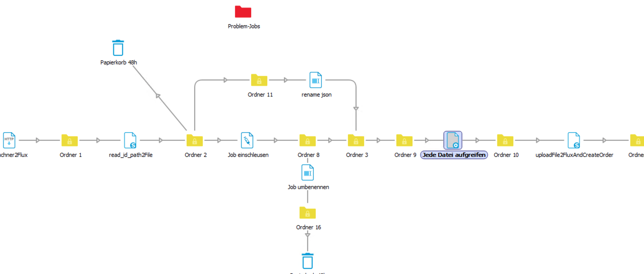

Is there a way to "File.read()" a File thats not in the actual Job-Folder of the Script? How can I refer to such a file? For Example the JSON file is in Folder 11 how can I read it by refering to it like File.read('Ordner 11/filename.json')!?

So you mean the Flow Element "Export Metadata"? So I cant use job.getVariableAsString( '[Metadata.Rational:Path="Opaque"] ')?
In My Flow I get a JSON from a WebHook within the JSON is the name of the PDF-File I want to print via "Flux Server API" and various information for the job.
So I need the PDF to upload it to the API and I need the json to send it to the API. When I put the whole json in privateData it doesnt work, I am not able to parse or read it as json anymore.

Okay this worked for me now:
var dataset = job.getDataset( "OpaqueJson" );
var jsonFilePath = dataset.getPath();
var jsonFileObj = File.read( jsonFilePath ,'utf-8');
var orderJson = JSON.parse( jsonFileObj );
- Bildschirmfoto 2020-11-20 um 10.57.22.png (83.66 KiB) Viewed 12679 times
The attachment Bildschirmfoto 2020-11-20 um 10.57.22.png is no longer available
