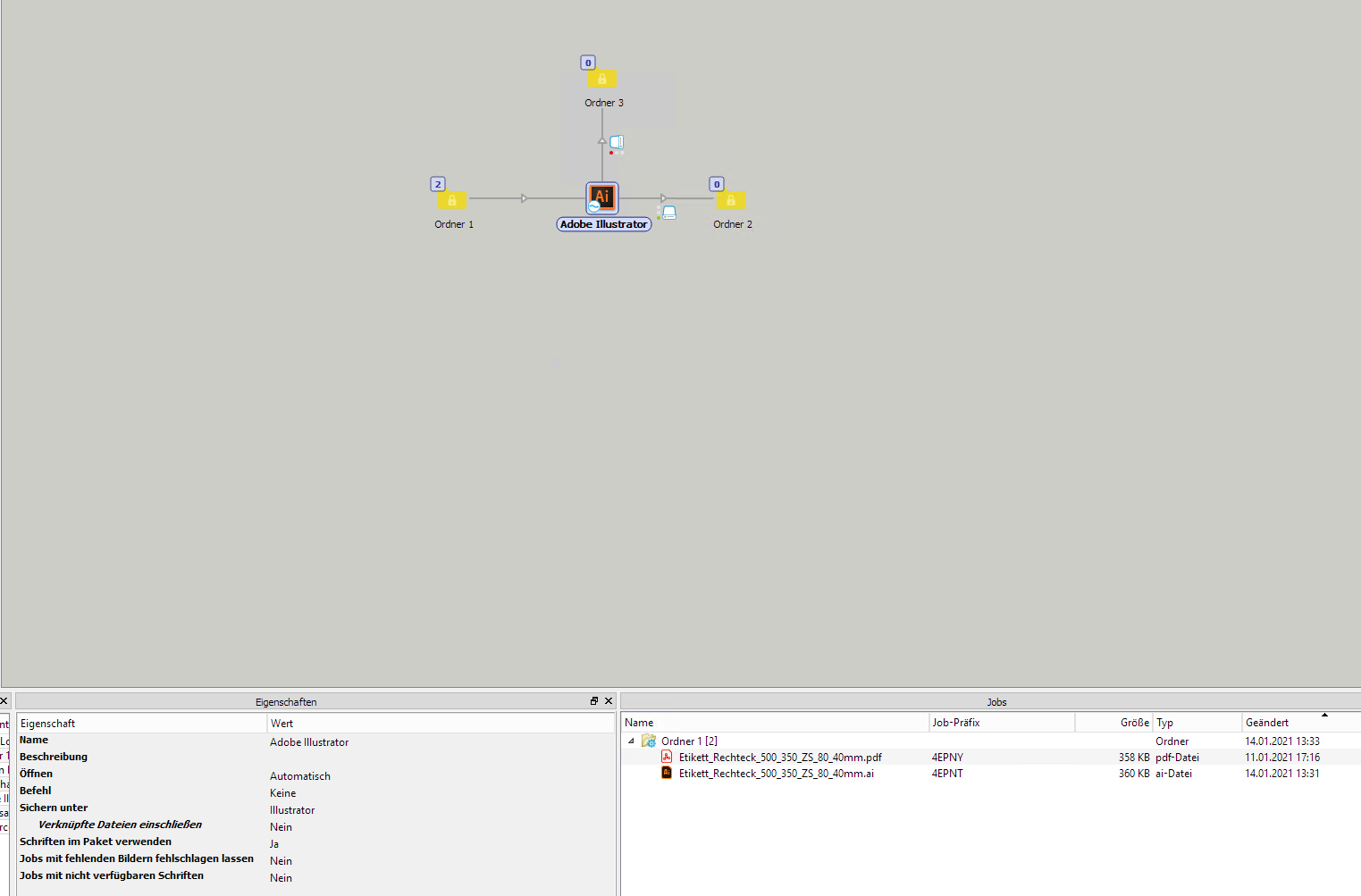

Unfortunately, I can't tell. I don't see how I can test this. That's why I dropped the post here.
First, I want to make sure that switch is communicating correctly with Illustrator.
If that works, I check the scripts or calls again carefully.

Can you make a flow like this?
- Input folder
- Illustrator element setup to open Automatically and save as Illustrator file
- Output folder
Activate the flow and then drop an Illustrator file in there. If the connection is ok, then you should get a resaved Illustrator file in the output folder.
If this flow works, then it will be something specific to the scripts or how they are used.
If it doesn't, then it is indeed the connection with Illustrator which is working. If it is not anything from the things already discussed in this topic, then I think it is best to contact Enfocus Support about it.

That sounds good.
I did that as described. First an Illustrator file, then a PDF file in the input folder.
But nothing happens.
I've also attached a screenshot. But our system is unfortunately in German.

If that doesn't work, then I think it is best to contact Enfocus Support.
