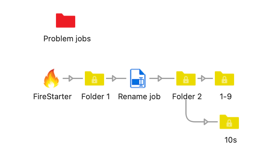

If you simply drop say 25 files into the IN folder, how do you decide which ones are number 10 and 20?

You can use some conditional logic based on a counter or a number in the file name. Here's an example using a counter in private data...
Flow attached
Does this do what you want?
May I ask why you are sorting the jobs this way?
*edited flow to send "all other" jobs to 1-9 outgoing connector
