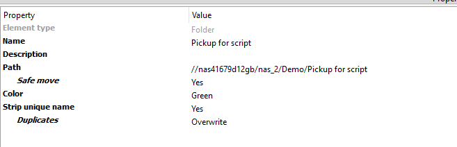

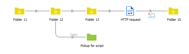

The idea we try to get you to understand is that this folder should not have an outgoing connection. Then the file stored in that folder will be without the prefix. For your script to be able to pickup the file you will set the folder to a path where your script can get the file.
In the property of the folder it is by default set as Automanaged but you can change it to a specific location that your Switch can reach, either local or on the network.
This folder should branch of in your flow right before your script. This will save you a copy on disc and the other copy will trigger your script to pickup the other copy from the local folder.

by jan_suhr
Something like this

Well this was an example on how to get you a file to use in what ever thing you want where you need to pick up a file from disc to use.
You can replace HTTP request with your script and write it to pick up the file from the folder I specified with a path location.

1. That is what we want.
2. You are not going to use job.getPath since it will give you the path to the file that enters your script. The file we put in the folder, point 1 above, is now forgotten by Switch. Since this location is static you have to write that path in the script and then use the variable job.Name.
Like this C:\\Mydisc\myFolderpath\[job.Name]
This will give you the proper file in to your script without any prefix.
3. Do as above, in point 2, and it will work.
This is how you will use Switch the proper way for this kind of case.

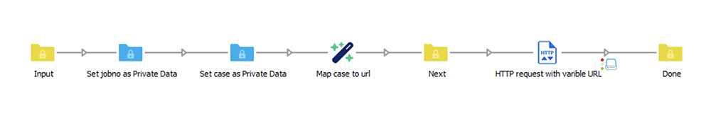

By looking at the script I guess you are doing the following:
1. Fetch a job number containing 6 digits followed by a dash and two more digits from filename
2. Fetch the 6th digit in that job number as case
3. Use that case digit to set the URL
If that's correct - here is a flow that does that using private data:
