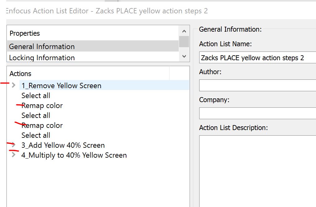

I am attempting to recreate what you did and can't quite figure a few things out. In "reverse engineering" your action list, I was able to remap in the way that you explained. Remapping the Yellow channel to Spot channel then Spot channel to CMYK. However, things fall apart or unclear thereafter.
One difference in my approach in this may be contributing to the error is that I wanted to delete that yellow 40% screen and then add a new one at the end. The reason for this is that it was extending beyond the bleed box.
Here is my action list:
action list_2.JPG (71.26 KiB) Viewed 15618 times
https://www.dropbox.com/scl/fi/94f0lrtl ... oxa5f&dl=0
I did not see in your list how or where you applied the multiply to the Yellow 40% screen when it is placed on top.
I see that you did reply to Freddy with a different course of action with another action list, but I have not tried that yet.
Thanks for your help with this.
After running my action list, I see that many pages are missing components, e.g., images, text, frames, etc., etc. This can be seen on pages 71, 83, 84, 85, etc. (page numbers in the phone book, not the PDF).

I think you should try to download the latest action list I made with Freddys input.
https://github.com/jimmyhartington/pits ... ply-v2.eal
And then look at how it is build.
If it makes sense for you to try and rebuild it, you can do that.
Let me know if you have any questions after that.
