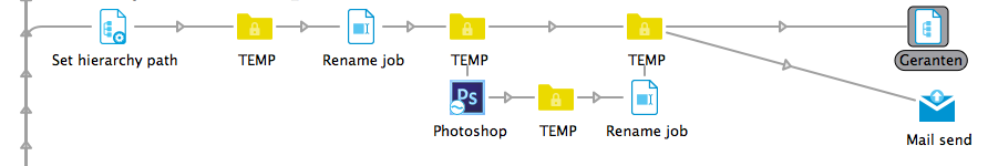

Included is a screenshot of a part of the flow.
- The set hierarchy alters the hierarchy so one subfolder is added at the top
- The rename job is there because all info is added as prefix and has to be removed before everything is placed in the archive folder
- The small sidetrack is build because the client wants jpg files from all files who pass the flow. The rename is used to add a suffix "_portal" at the end of all the jpg's.
Thx
Bart

I'm not 100% sure but I'm not sure if Set hierarchy path will create a folder?
You can add a Assemble job between your temp » Mail send so it will assemble a folder which will trigger the Mail send only once.

If set the Submit hierarchy in an earlier flow to subfolder levels 1 in stead of 10 and let it follow with an Ungroup job. Just before the mail I do an Assemble job. That does the trick.
Thx for all the help!
