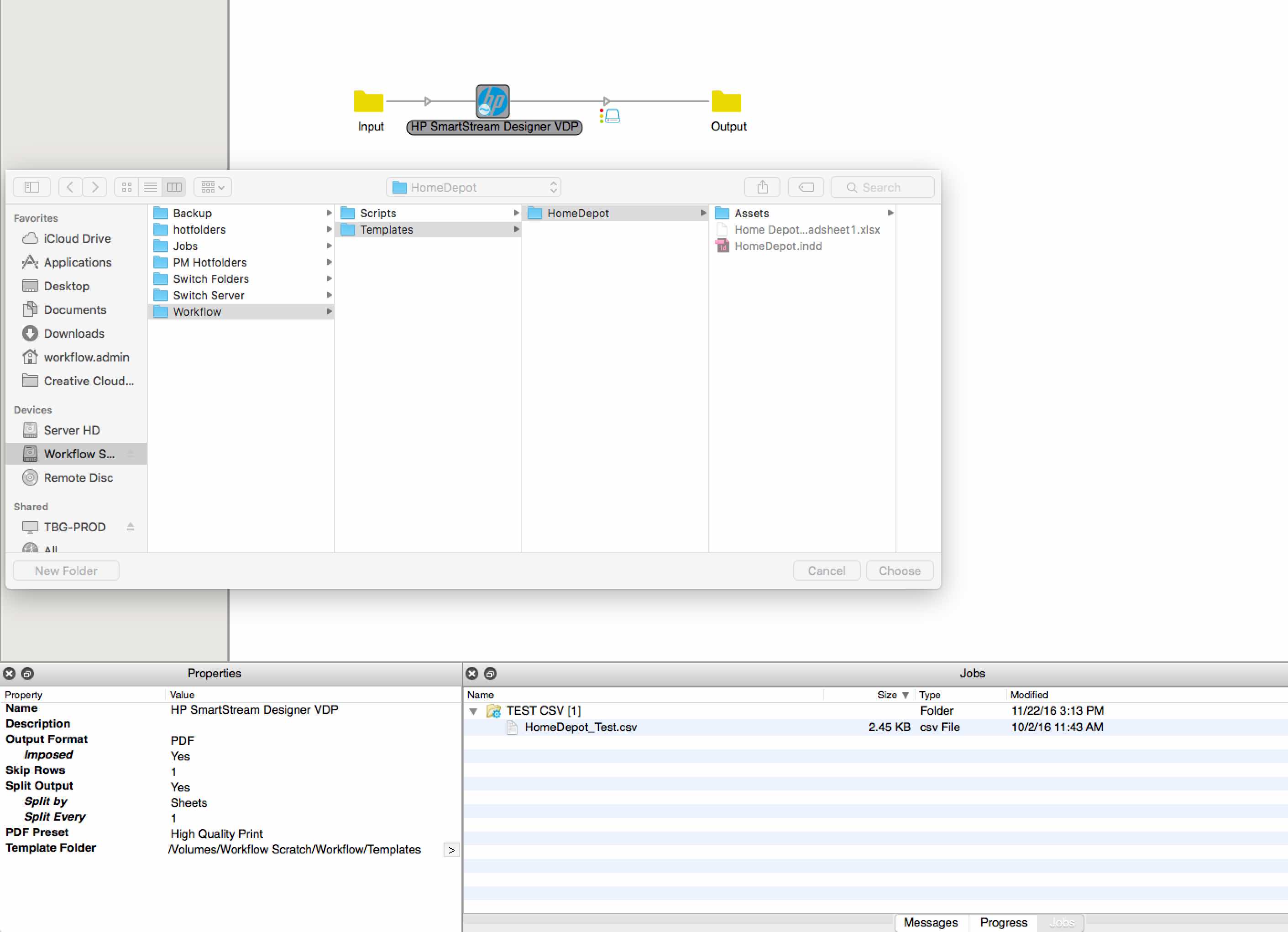

My configurator is setup to go to the root of the Templates folder. Inside I have a folder called HomeDepot. My Indesign Template is called HomeDepot.indd. My CSV file is called HomeDepot_Test.csv ( I have tried renaming to just "HomeDepot.csv") Always with the same results, drop the file, it launches InDesign and nothing happens. I don't receive any error from SWITCH it just doesn't do anything.
Screen Shot 2016-11-22 at 3.15.51 PM.jpg (199.53 KiB) Viewed 328869 times

That looks correct. Check the version of InDesign that Switch is using. Are your CC credentials valid? Are your SmartStream credentials valid? Check on your license.
Create a log out and post the XML log (doubtful anything useful will be in it though).

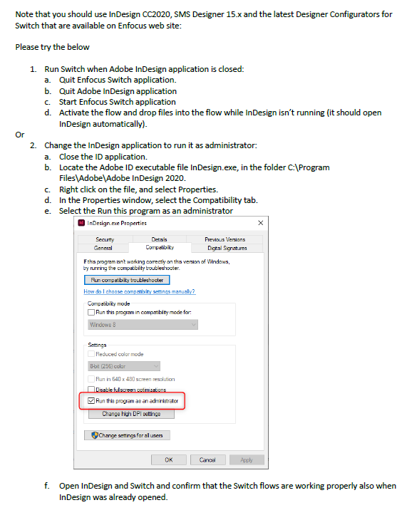

It was a while ago that I had the issue and I have not used the Smartstream VDP plugin for a while but I found upgrading to Indesign 16.0 fixed my issue. I would suggest to make sure that you don't have any other versions of indesign installed on the server and that you have the latest configurators.
This is what I received from HP, but to be honest this didn't fix my issues at the time.
Screenshot 2021-11-18 091755.png (77.42 KiB) Viewed 314098 times
