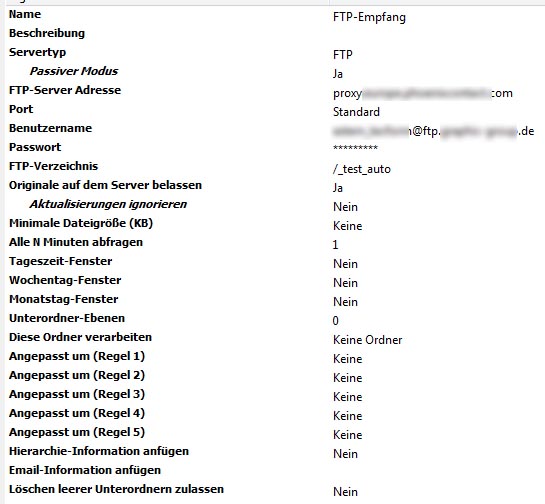

2. FTP receive properties
- Passive: Yes
- FTP-Server-Adress (I tried different combinations like this): userproxyserver:passwordproxyserver@proxyserver
- Port: Standard
- Username: userftpserver@ftpserver
- Password: passwordftpserver
I receive this answer from the log:
"Es kann keine Verbindung zum FTP-Host aufgebaut werden. Fehler: The requested name is valid, but does not have an IP address at the Domain Name Server. Please check the DNS setup."

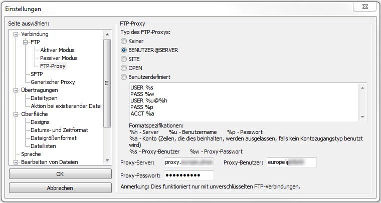

Where and how are you filling in the proxy settings in Filezilla? I have seen that there are two places in the Preferences, one under Connection - FTP- FTP proxy and one under Connection - Generic proxy.
If you use the FTP proxy then configure it as described in the manual: No proxy, etc. If it is the generic proxy, the settings look very much the same as in Switch, so you can just copy them.
Note that the documentation says that appending the user name to the FTP site address is done on the "FTP receive" and "FTP send" elements. That means that you do not do this in the Preferences!! And that this is only done when using an FTP proxy.

Re: How to setup FTP proxy preferences
Unfortunately I'm filling the proxy settings in FileZilla unter "Connection - FTP - FTP proxy" and not the generic settings.
I have transferred the settings to the Switch preferences window. I have tried all "Proxy Type" setting, but due to the manual it has to be "No Proxy".
After that I make the setting in the FTP receive tool (also due to the Switch Online Manual):
- FTP-server-adress: will get the proxy-adress
- User name: ftpuser@ftpserver
And the rest as usual. Is there a change between the versions Switch 11 and Switch 12? I read some hints in the release notes...

In the actual Switch version it was not possible to get a "FTP receive" connection via user@host over a proxy that needs authentification with proxy-user and proxy-password. This task was taken by Enfocus as a feature request for future versions.
Actually the solution is to contact the FTP server over proxy without authentification. Setting the credentials like written in the manual (see: http://www.enfocus.com/Manuals/UserGuid ... ences.html) will work for us.
