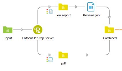

However, I'm still having a bit of an issue with it. When I run a file through, it does generate a report, but I found that there are a few weird things about it.
1.) the stop light connection wouldn't work with "data with log" selected, I would only receive back the pdf. So I ended up making 2 folders with 1 allowing "log" and the other allowing "data" to pass and then combined them back into the same folder. Is this normal?

There is a common misunderstanding that "Data with Log" creates 2 files in the output folder. It creates 1 file in the output folder and the Log part is attached as a dataset (in other words as metadata).
So if you use "Data with Log" as output from PitStop Server and the report is an XML file it is automatically attached as an XML dataset. If the report is a PDF, then it is also a attached as a dataset, but the obviously as an opaque dataset.
For those who need both a PDF report and an XML report: the PitStop Server configurator has a property to create an "Additional XML report dataset name".

Ah, this clears some things up, looks like i can get what i need now! Thank you!
