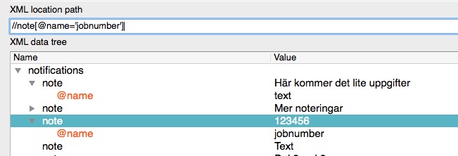

You can construct the X-Path to go by the tag and attribute value.
Then you are not dependent on the order of the tags, it will go by the attribute.
Screenshot 2017-01-27 16.53.58.jpg (37.28 KiB) Viewed 10360 times
Screenshot 2017-01-27 16.54.18.jpg (16.65 KiB) Viewed 10360 times
In your example it would be //dn:Row[@your_attribute='attribute_value']
