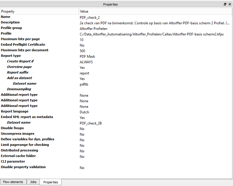

After the installation, total restart and update of the configurator, the datafield for the dataset name was available in the property window again. In its normal place. Only the default value was set, so I had to enter our own specific name which we used before.
Schermafbeelding 2017-03-30 om 13.06.53.png (55.33 KiB) Viewed 14349 times
