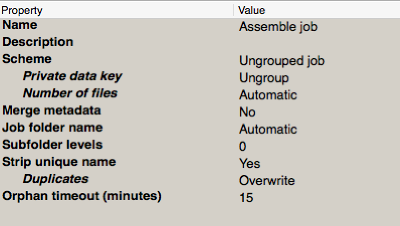

I feel like I'm missing some minute of your Flow but could you set the Assemble to :
Screen Shot 2017-06-22 at 10.19.41.png (52.05 KiB) Viewed 16675 times
Or whatever the Private data key is. Where are you having to set the time to 1?
This feels like an error in your setup for assembly or merge.

TheCaptain - yes, I tried the settings like that - assume issue may be as Sander raised that I'm dropping in PDFs.
