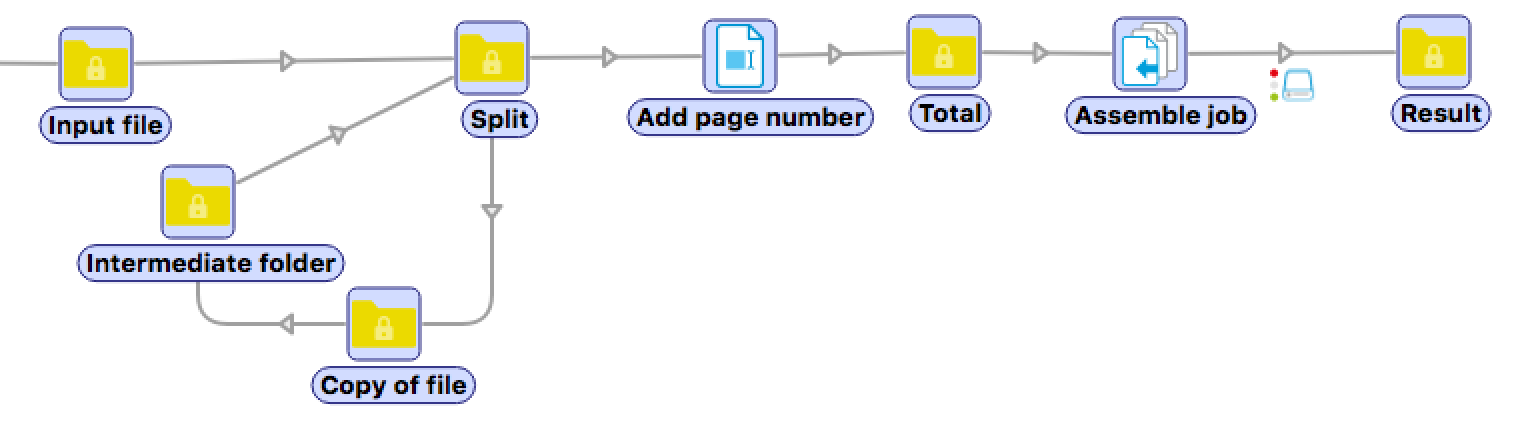

by freddyp
Impressive Sander, but how about this solution? ;)
Screen Shot 2017-06-23 at 13.48.48.png (55.18 KiB) Viewed 23724 times
Both your and my solution duplicate pages like this 1234,1234,1234, but perhaps it has to be 111,222,333,444 or still something else? The apps handle it all and in a much simpler way.
