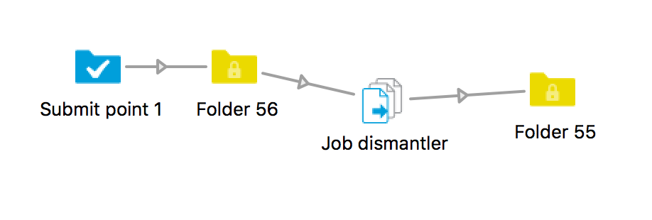

This : is producing 2x pings in the Web Portal 'Check jobs'

Padawan
Posts: 367
Location: Belgium
Re: Web Portal // Questions
Post by Padawan »
I assume there are two Switch jobs in Folder 55 after the job is dismantled? If so then I think that's the reason why there are two shown in the webclient.
The two files in Folder 55 might end up together in one print job. But Switch doesn't try to keep files of the same final print job together. It just sees every file or folder in it's flow as a different Switch job.
TheCaptain
Posts: 86
Joined: Mon Jan 18, 2016 4:22 pm
Location: London
Post by TheCaptain »
If I drop a single screenshot directly into the Submit Point, then pass it through the Job Dismantler, only one file pops into the final Folder.
Yet the Web Portal shows multiple instances of 'Complete'.
Mayhap this is one for the Enfocus team. I'll report back...
TheCaptain
Posts: 86
Location: London
Enfocus have confirmed that this is a bug and has been added to the list for potential future updates.
