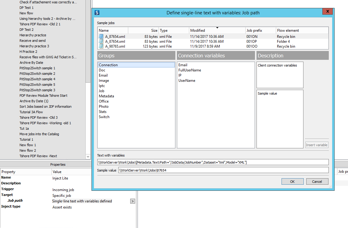

Thank You. That does seem like it should solve my problem. I did install Inject Lite and am using it, but I am getting an error in my flow- "Error in line 101 of script : Error. Trying to access undefined member '1'". Any idea what may have caused this?

Not really sure. Can you post a screenshot of the app/script properties you are using?

Here are the properties of the app:
inject prob.PNG (59.22 KiB) Viewed 21590 times

I think it might be that preceding "\\". Is there another way it could be addressed? like "file:///" or "/Volumes/whatever"?

gabrielp wrote:I think it might be that preceding "\\". Is there another way it could be addressed? like "file:///" or "/Volumes/whatever"?
\\ - double backlash is for a network path.
If the file sits on a network location - pointing to it with double backlash or going per Network and the actual device on the network, will always result in the path starting with '\\'
Correct me if I am wrong.

Every backslash has to be escaped, so your initial \\ has to be written \\\\

I got it to work, it ended up needing to be the Forward slash instead of the backlash (//workserver/work/jobs/) which ended up working. It must have something to do with the way Inject Lite uses it, because it works fine as \\workserver\work\jobs\ in Switch. Thanks for your help.
