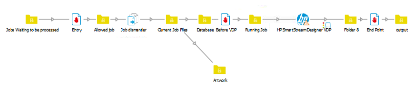

Im Trying to Get a Job to run in VDP only one at a time because if another job attempts to enter the segment of the flow it will overwrite the artwork for the job that is currently running. I need a single Folder to pass a Hold job point and wait until VDP outputs something (or timeout if it never reaches VDP). im currently using the code below

However when the flow starts it trips the entry script without actually sending a file... and then the files are stuck there. Im looking for a way to wait until the flow has validated and will actually allow the file to pass the hold point before actually running the script in the entry point (all 3 are hold points with scripted release expressions)

I would build a flow where:
- You have one Hold Job, on the location of the current "Entry" Hold Job
- You set "Delay scheme" to None in the properties of the hold job itself
- In the properties of the outgoing connection of the hold job, set folder constraint to Yes
- Set maximum file count to 1
- Set target folder to the location of your Artwork folder.
This way the Hold Job will only allow jobs to pass when the "Artwork" folder is empty.
