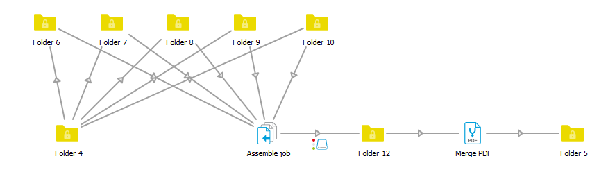

I was wondering if there is a way to take an eight page PDF and create a 40 page PDF with the original eight pages... So I currently have 1, 2, 3, 4, 5, 6, 7, 8... I would like 1, 2, 3, 4, 5, 6, 7, 8, 1, 2, 3, 4, 5, 6, 7, 8, etc until I hit 40 total pages...

Probably not the best way... but it works... :lol:
