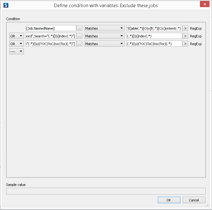

Basically I am trying to create a Connection based on whether an incoming JobFolder contains a file which NameProper matches any of the three defined RegEx conditions.
So if the file which name is matching one of these:
(.*)[T|t]able(.*)[O|o]f(.*)[C|c]ontent(.*)
OR
(.*)[I|i]ndex(.*)
OR
(.*)(\s)(TOC|ToC|toc|Toc)(.*)
is in the incoming job folder - then go on connection A, if there is no file matching any of the above RegEx, then send the whole JobFolder on Connection B.

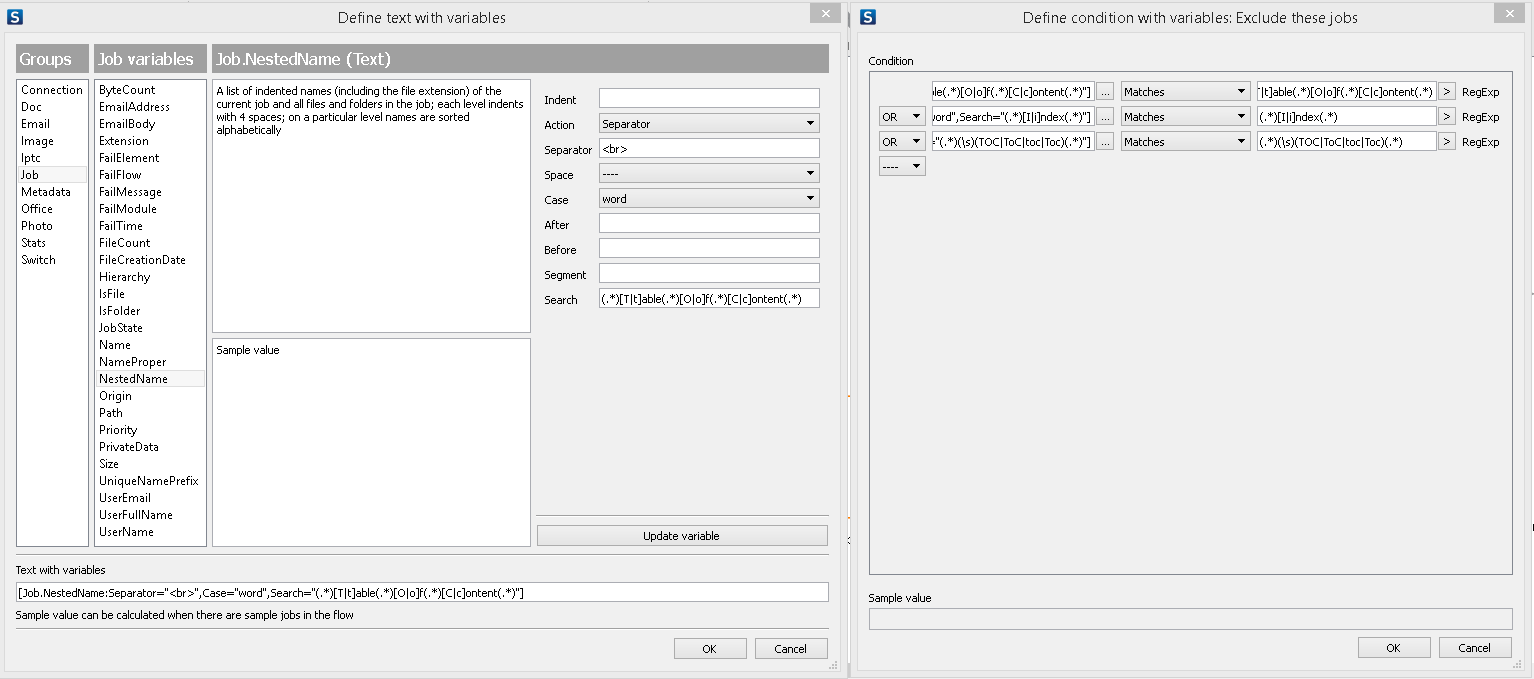

I have tried to set a variable for [Job.NestedName] to match the RegEx (as per line 1);
I have tried to set a particular result of ie.: [Job.NestedName:Search="(.*)[I|i]ndex(.*)"] to match or to not match the RegEx...
And while all of those return properly True / False in the config window, are properly validated when flow is activated, when the job comes - it goes to Problem Jobs, as there is no outgoing connection that would accept the job.
I shall add, that when there is no RegEx involved, but a strictly defined filename that is to be looked for inside the JobFolder, then it works fine.
How shall I then properly engage the RegEx Criteria for the filename contained in the JobFolder, so that it worked properly?

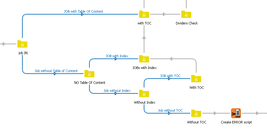

connection A - accept jobs that match RegEx 1
Connection B - all others
connection BA - accept jobs that match RegEx 2
Connection BB - all others
connection BBA - accept jobs that match RegEx 3
Connection BBB - all others
And it seems to work fine so far.

Unfortunately not, we do not have a Scripting module. The far end right element is a Execute Command Friend, where I create a BAT file, which basically is a text file, so gets then renamed to a TXT and passed further to the final folder as an Error Message regarding the whole Injected JOB :)
Neither we have a Switch portal to output custom error messages for the users there, so I had to go with a simpler yet still working solution to just get a Text file with Error description.
There is not a lot of errors possible - basically just 2 possibilities, so although it is not very elegant - I can live with it as it just works.
