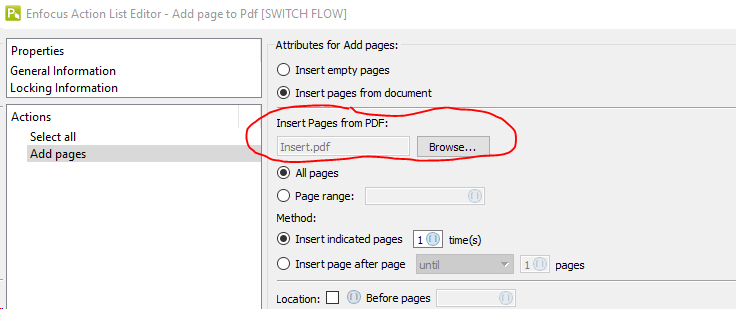

i am looking for a way to insert a page to a pdf via Switch & Pitstop server 13 update 2. the action list for this is Add pages. the problem is:
the insert page from pdf does not have a variable option. :shock: so it will always insert the same file. is there a way i can make this variable?

that was exactly what i did, the problem is the action list embeds the original static.pdf you select and does not replace it with the new one you submit and replace via Switch client.
