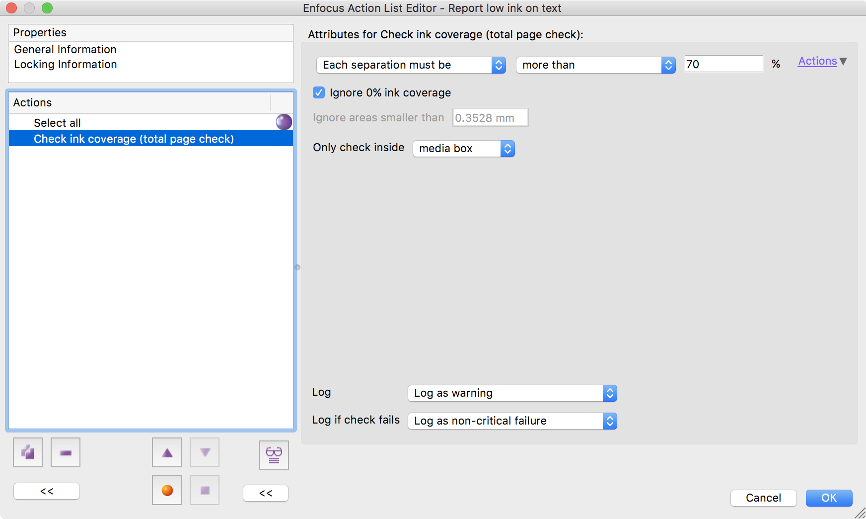

In version 2018 there was a change in the "Check ink coverage (total page check)" action. It now allows to set a maximum ink usage per separation. This is kind of what you request, except it is not possible to limit it only to text. Is this sufficient for you?
Once you create an Action List like in the below screenshot, then you can add it to your preflight profile. You can do this in the Action List category of the preflight profile editor.

Thanks for the reply, I think your suggestion will end up flagging up errors in most files as it's just text that is causing issue. For example if I have a 30% tint of black making up a 4 colour image that's fine, but if there were some small text in 30% Black only then that would cause issue.
