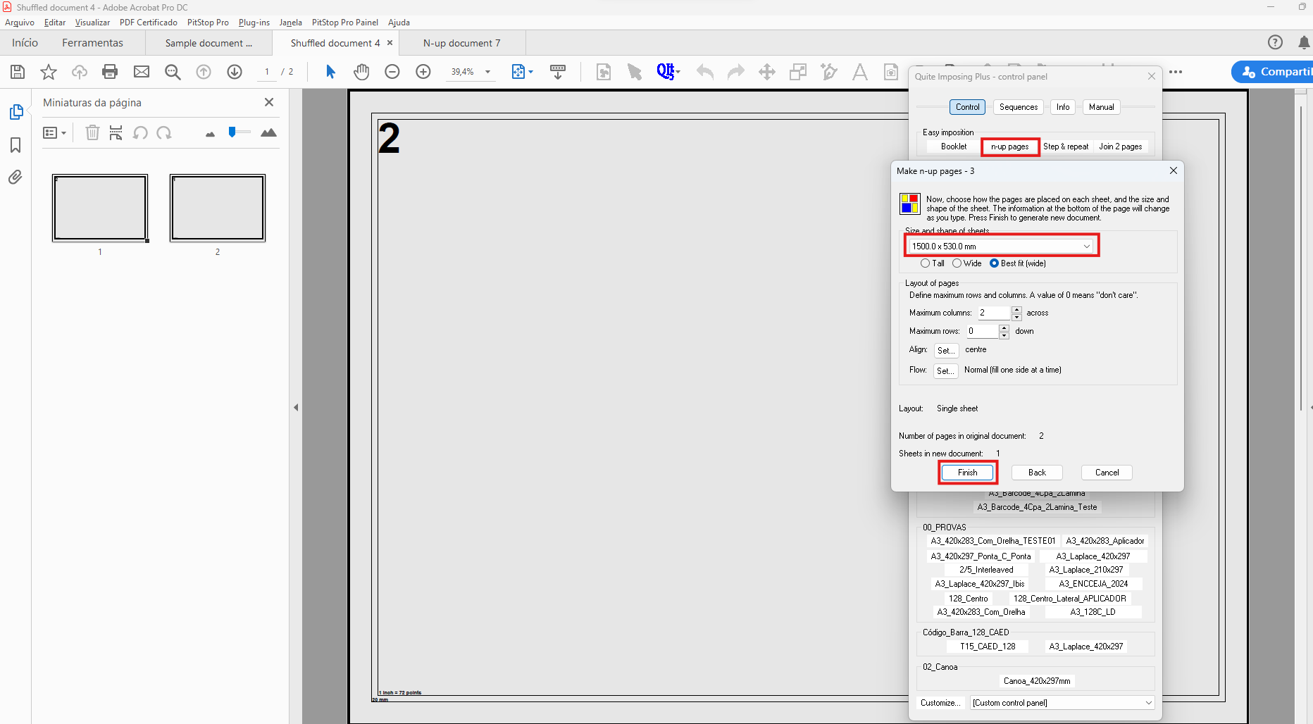

there is someone who is familiar with quite hot imposing, I want to place an A3 lying 2x but I can not. I made an example pdf for the 750x530 format but he does not place it. Original disappears and in case of error I only see "error". does anyone know how to do this?

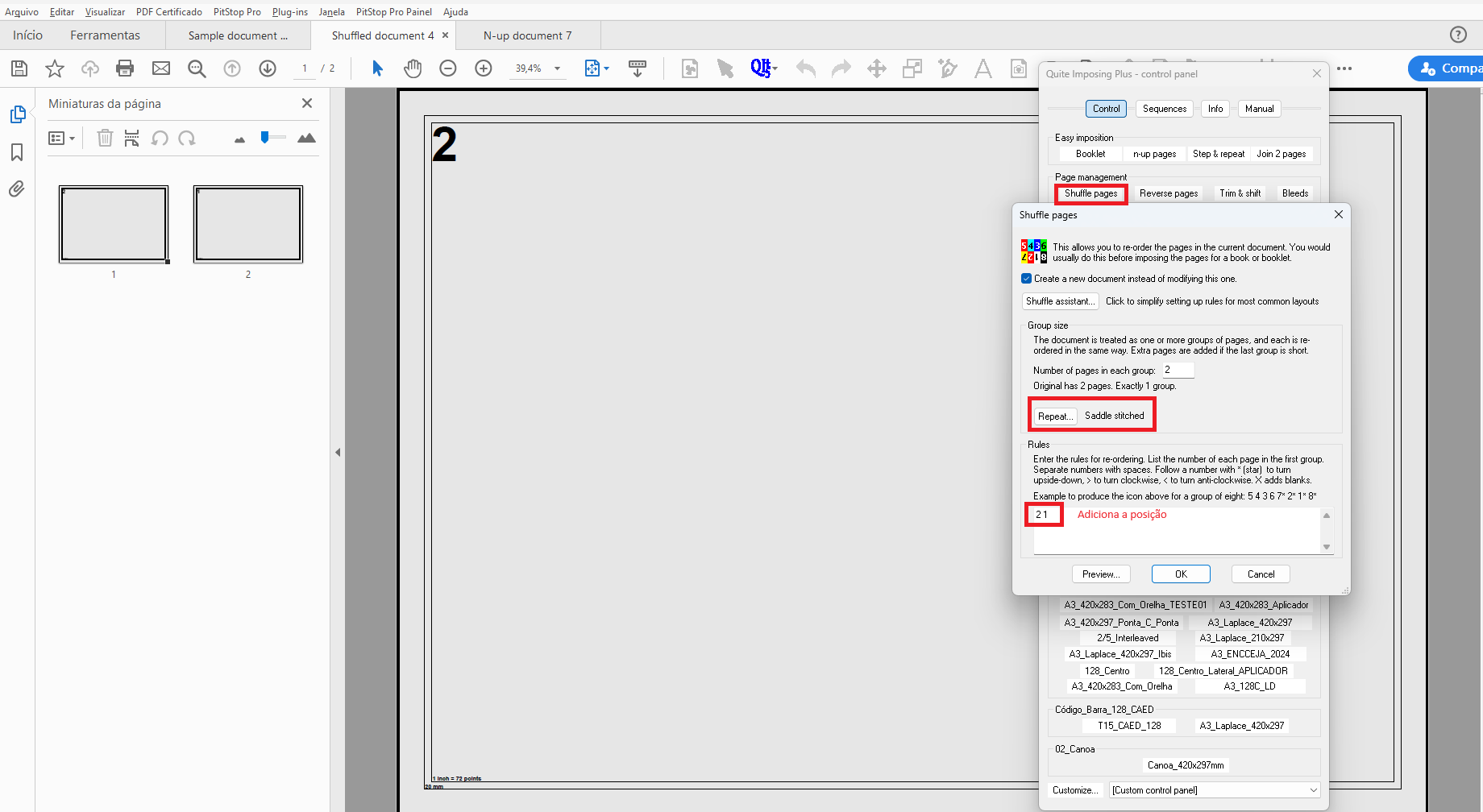

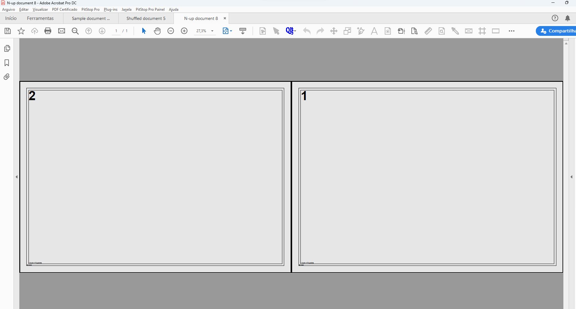

Segue o exemplo criado no Quite Hot Imposing
1- Passo.png (84.39 KiB) Viewed 22290 times
2- Passo.png (84.07 KiB) Viewed 22290 times
3 - Passo final.png (34.59 KiB) Viewed 22290 times
