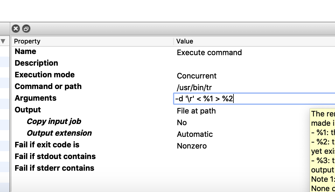

Hello,
I can't get the execute command working for the tr command in mac-os.
I tried to quote the %1 and %2 but no results.
Anybody an idea? Thanks!
Screenshot 2018-12-16 at 22.32.26.png (134.16 KiB) Viewed 7192 times
The attachment Screenshot 2018-12-16 at 22.34.45.png is no longer available

Have you tried to put quotes around the variables?

You are using redirection in your command (the < and the > in the command). These are features of the bash shell in Terminal. The execute command tool doesn't use the bash shell, instead it uses direct OS commands. Therefore redirection (and piping) doesn't work.
To get them to work you will have to use a bash script to do the task and use the Execute Command tool to start the bash script.
More info here:
https://www.enfocus.com/en/support/know ... 000jfc9IAA
The Execute Command Friend App might also help you out to write the bash script.

Thanks all!!
Problem solved with bash script.
