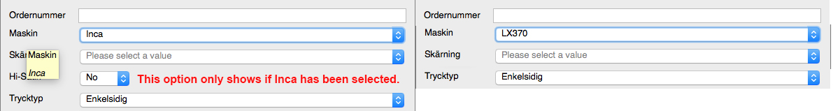

I have a submit point for my flow where I use nested menues to select Printer, Cutting method and Stock. However I'd also like to add a Multiple pass (Yes/No) option for one of the machines, independent of the Cutting and Stock choice. Is that possible?

Hi Lasse, yes it is possible.
In the Metadata fields setup you have small green arrows pointing left and right. Select the field and click the right arrow. Now that field is dependent on what is selected in the "Maskin" dropdown.

Thanks Jan.
It took a while to figure out how to get it to show, but after a while I figured it out.
The key was to place it at the same level as the Cutting options, and set the parent value to Inca.
