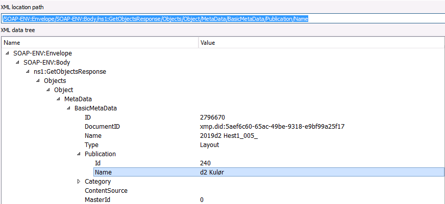

Are there anyone who knows how to search in Define single-linge text with variables (Build Location path)
Example: /SOAP-ENV:Envelope/SOAP-ENV:Body/ns1:GetObjectsResponse/Objects/Object/MetaData/BasicMetaData/Publication/Name
Here It return name d2 Kulør that I need.
But How to search the same name (d2 Kulør) if not in the same container, so I always find the right container
Best Regards Ulrik

If you use "//Publication/Name" you should find all "Publication" nodes with a child "Name"
Thats because of the double slash

Hi r.zegwaard,
Thanks for your quickly reply, but I can't make it work I've tried but this one
/SOAP-ENV:Envelope/SOAP-ENV:Body/ns1:GetObjectsResponse/Objects/Object/MetaData/BasicMetaData"//Publication/Name"
Is that the way you mean ?
/Ulrik
