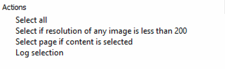

You can create an action to pick up low res per page.
This made need to be extended to report page by page.
Screenshot 2019-02-12 09.17.38.png (36.79 KiB) Viewed 15377 times
You can then use the xml for the variables in the email.
