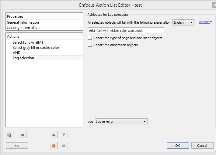

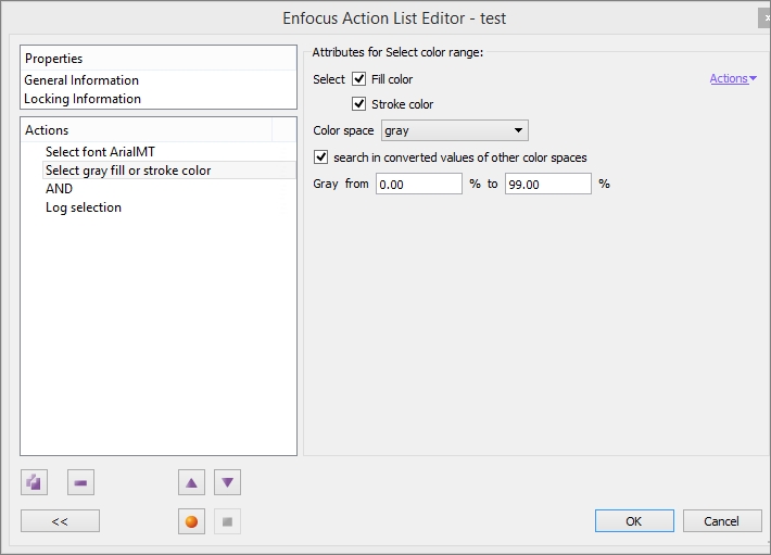

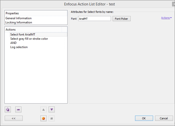

Can you try using an action list with this format?
1. Select font Arial
2. Select gray fill or stroke color
3. AND
4. Log selection
Number 1, select the font you want to detect.
Number 2, tick both fill and stroke color and use gray options as a color space. Tick as well the "search in converted values of other color spaces" option. Set the percentage from 0 to 99. You can experiment this setup to achieve your goal.
Number 3 will select both conditions.
Number 4, you can choose the log type as an error and include your message in the text area.
3. AND
4. Log selection

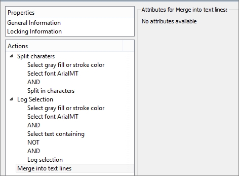

Thanks for the suggestion. However, this solution still selects invisible characters - e.g. spaces
Re: Find fonts only with visible characters
Sorry, I did not think about spaces. Anyway, I've made some few modifications on the action list to exclude spaces from the selection stack by using the Select text by key phrase. At first, it will deselect text lines with spaces so I have to split the text line, select the text and merge it again.
Here is how it looks: I also included the action list for you. Hope it helps.
